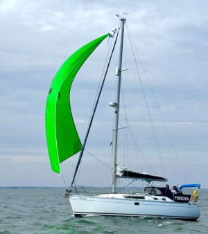

I have managed to use the cruising chute a few times now, thank you for all the guidance. latest time down wind on way back from Lowestoft to Harwich in light airs. Dropped mainsail on that occasion to see if it made a difference.
