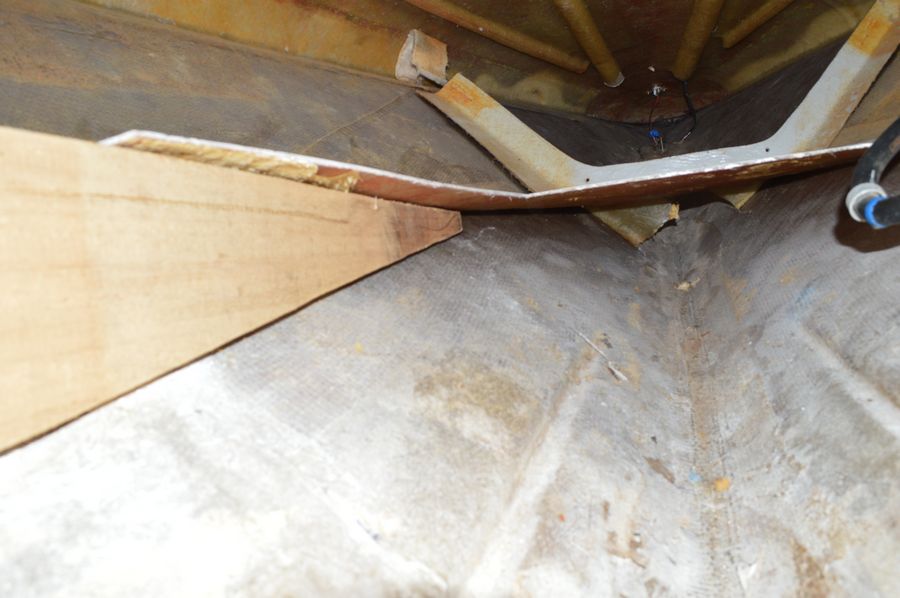

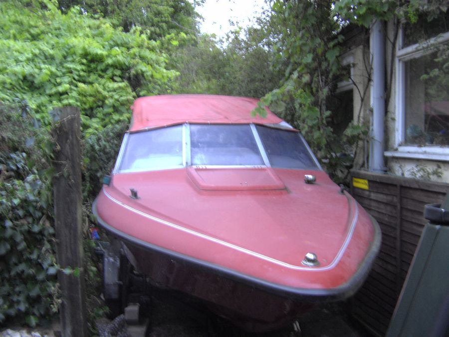

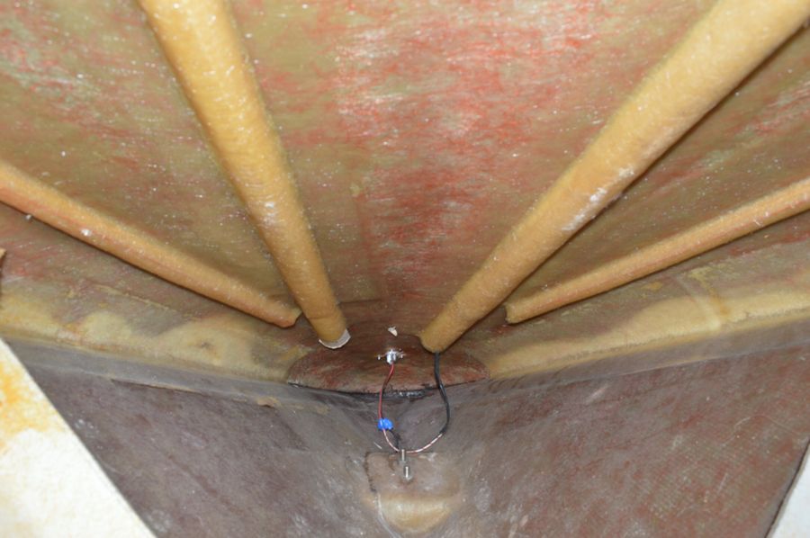

Found a few pictures to help illustrate:
External view
Inside - underside of bow etc taken from forward edge of cuddy - i.e. previously 'dead space'.
Wider view - the V frame is what remains of the forward wall of the cuddy (a section of cloth covered ply attached) and is about where I envisage an anchor locker bulkhead. Taken after removal of some cuddy floor, buoyancy foam (waterlogged) and prior to glassing in of new stringers etc (now done).
