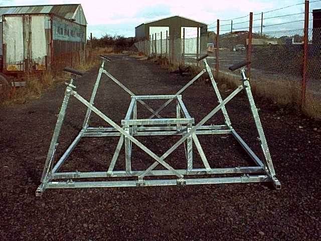

Here's someone doing it low tech on a Kingfisher 20. This system could be improved by using a contoured support instead of chocks, but worked. They wanted to do precisely the same work I do.
Below that is a system for a drop keel by Tennamast which would probably work, dimensions allowing. Wood block on central support.

1. The Kingfisher has far better access because he's supported only on two tranverse beams. EXACTLY as I described to you back at start of this ridiculous charade. You even say : "
They wanted to do precisely the same work I do."
Bet they did it without all the fuss and crap you seem to want to give out.
2. The cradle system you then show - try getting your arse in and out around those metal suports and central box section. I GUARANTEE you will be blocking the boat up to try and beat that little problem.

No, the yard put beams longitudinally under the keels, not transversely upon piles like that, hence limiting access under them. It was no better than being on the ground except, perhaps, to dry off. Or offered blocks/chocks front and back, meaning having to raise and lower each corner to work on it which was no good for me. Actually, being able to work on one's back under the hull was OK, as one could acquire better leverage, but it was of no help at all in the doing the keels which is the main purpose of it all.
I wasn't after more room under the hull, or intent on doing an annual slop of anti-fouling, just to be able to work the edges of the keels.
Like you, they appeared to find it difficult to grasp what the real issue was and just wanted to do what they always did (actually, just not do any work at all), without asking whether it was what was required.
