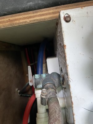

I want to install a cockpit shower on my yacht. I have hot and cold pressurised water and there are both hot and cold pipes accessible from the cockpit locker. Can I put a T piece in anywhere along the hose or does it need to be in a specific place? I have attached a photo from what I can see in the locker.

When i did mine I put a 'T' in both lines and then isolation valves. I adjusted the isolation valves so I got the correct (for me) water temperature then I put a shower hose with a flow valve on the shower head.worked fine for 6 years.
Edit..
You may have to put a third isolation valves or two non return valves to prevent the hot and cold mixing when you use other taps.
Thanks. The shower is an Osculati with a mixer valve and hot and cold feeds. I just want to make sure I connect in the right place before I cut the pipe! The heads is the other side of the bulkhead where the pipes in the picture are so if I tee-off just before where they go through the bulkhead I should have a hot and cold feeds?

I fitted a thermostatic mixer valve between the hot and cold pipes, so the temperature of the shower water was consistent
Absolutely agree, a thermostatic mixer valve makes for a much nicer experience and also avoids wasting water while adjust the temperature. Once set, just open the manual tap to hot only and the temperature is always the same comfortable temperature. I have mine set to 38 degrees. Pardon our interruption...

Getting back to the shower I find a simple mixer connected directly to the hot and cold water works well but there is an obvious danger of scalding if the engine has been running
