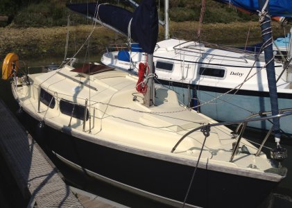

As you can see here the tabernacle sits on a raised section of deck, so should be impossible to have a puddle anywhere near it. It's all GRP so not terribly hard to fix for anyone with a desire to do so. When looking at these it's very likely the bilge will be full of freshwater. Don't let that put you off, the hawse pipe and cockpit lockers both gradually leak rainwater in due to some design issues, but it's only a problem if left for months. The windows will also likely leak if not regularly maintained but are easy to re-seal with a little bit of black goop.

Oops! Apologies, my mistake... I had the wrong boat it was a Vivacity 650, not a 20 that I looked at. Her standing rigging went to the cabin top, she had no side decks and there was definitely a puddle at her mast foot.
