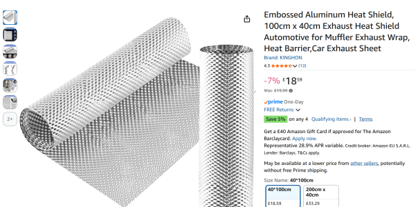

Anyway, it is mentioned that the wrap stuff will seem to smoke a bit as the chemicals burn off, it's also known that they do attract condensation and will steam as they dry out when the heater's on, so I persevered with it for about 30 hours running, and still had a 'smoky' cabin, which is the problem. The smoke is largely steam, but also still the stuff from the wrap. I do have a gas/particulate meter, and it reads as everything being OK, but it's not right, so I changed the wrap out for straightforward aluminium wrap, which seems to be a far better solution for me, albeit after only an hour of running. If I'm the only one who's suffered this, oh well, but it might help others.

It seems to me that what you have bought will not insulate the pipe - aluminium will conduct heat - but is the type that might be used only to shield it - i.e. keep anything from getting close enough to it to touch it.
Quite where the smoke is coming from I don't know, but could be some coating or manufacturing residues burning off the pipe as mentioned, or perhaps even the bulkhead or something else burning if the heat is being conducted to it by the aluminium shield mesh that might also be touching the pipe.

Yup, the aluminium sheet will simply diffuse the heat, and also contain the highest contact points. I was feeling along the ally sheet yesterday, and it wasn't ever untouchable.
Where the exhaust goes through the bulkhead is well protected, and there's no evidence of scorching at all.
The coating on the wrap should've burnt off by now, which is why I believe that I bought a wrap of crap.
The same wrap also seemed to conduct moisture, which took time to steam off, and did present moisture to the area.

Your laser temperature readings will not be accurate, due to highly reflective surface . If you want an accurate reading, paint it matt black . Heat resistant paint recommended lol

You can wrap the aluminium shield, without taking it apart, by using some of this, other sellers available (without the marine tax)
Exhaust Lagging Glass Tape
In fact that's very similar looking to the stuff I've got!
No, I'm not convinced that I've done a good enough job on this heater anyway, so for all of the time it'll take, albeit a real PITA for access, I'll remove the exhaust, and then proceed, probably with the aforementioned sleeve.
