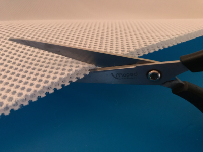

I'm going to get either some air venting underlay

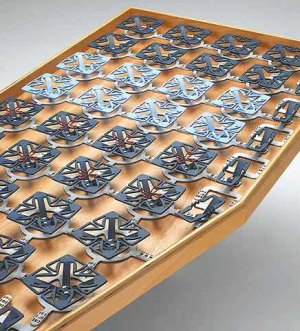

Or if it's worth it some of the Froli springs.
Obviously the Froli system is a lot more expensive, is it worth it and does it work well with thin cushions? Also I have a locker lid of around 50cm square which I assume I could screw a small number of the squares on to so it can still be removed?

I have the froli system and it did massively reduce the condensation issues. I managed to buy it on fb marketplace so wasnt expensive. Another option is timber bed slats. I also sit bed cushions on their end after we get up to air

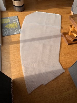

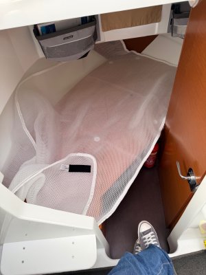

I’ve gone for the ventilated mat first to see if it improves things and will take all the suggestions above on board.
