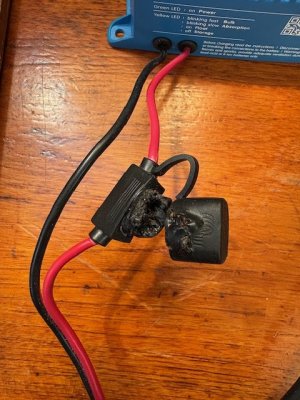

IMG_8305.jpgI monitor my boat via VRM and noticed something unusual so emergency flight to Valencia this weekend. Arrived to find the automatic bilge pump running continuously dry which explains the battery voltage.
However I did a quick inspection of everything and found this! The charger wasn’t on as I leave the boat with solar to top up the battery which is fine so long as the pump isn’t running continuously.
So that is the vctron ip67 own brand in line fuse holder with the remnants of a 20amp fuse. I have no idea when this happened except that it’s within the last year.
The scary bit is that the charger worked like this. The melted fuse didn’t break the circuit. !!!!
Anyone else with this charger might want to check.

By the looks of it, it is only the housing that has melted not a blown fuse, hence the charger working normally. Can you think of any reason why the housing got hot. I wonder what the melting temperature of that material is?

I suspect the fuse got hot and melted the housing, rather than a fault. I'd cut it out and put something at the supply end of the cable, which is where it should be anyway.
You’re right Paul, in my experience when a fuse is never cleaned, corrosion builds up on the connections causing high resistance and heat. The old plastic “Continental” fuses where a bugger for this as the plastic body would melt.
What was the problem with the automatic bilge pump?
It was a blade fuse as fitted by OEM so I don’t know the brand. The plastic cap of the fuse was completely melted and had fused the holder closed. More pics when I get home.
