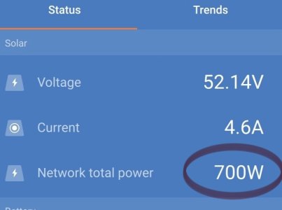

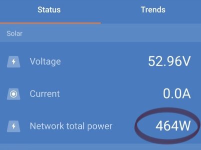

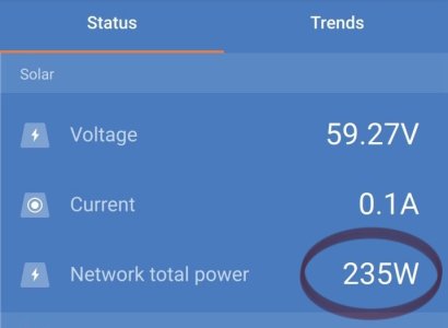

Here is a practical example showing the effect of one, two, and then three chargers connected to one battery bank.
These are three identical solar chargers, but the algorithm and result would be identical mains-powered chargers.
As you can see:
One charger is delivering 235W.
Two chargers are delivering 464W.
Three chargers are delivering 700W.
If the test was repeated later in the day when the lead-acid batteries had a higher state of charge, the limited charge acceptance would start to kick in. The battery bank would be unable to safely accept the full 700W output, but this is equally true if there was a single 700W charge source.
This shows how three chargers each capable of delivering around 233W are behaving the same as a single charge source capable of delivering 700W.

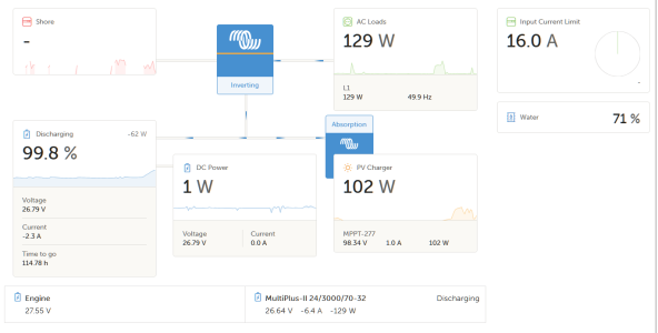

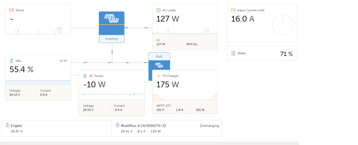

The following screenshot was taken earlier today, with the mains charger off.
I turned the mains charger on and the solar worked OK for a while, but as the batteries SOC rose, the solar reduced

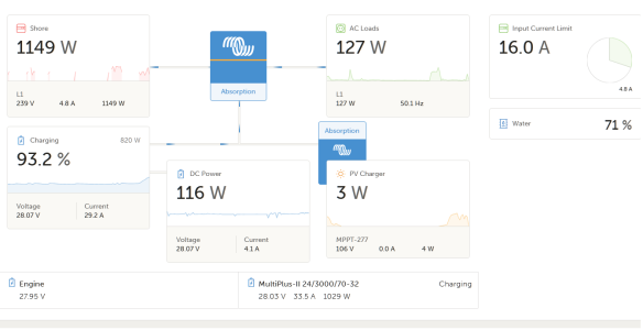

I imagine a couple of people will now claim that the reason the solar yield has now dropped is because the batteries are almost fully charged, but note the shore charger is still putting 29.2A into the batteries.
The solar panel output has reduced to stop the battery voltage riding above the voltage set point and damaging the battery. The 939W put out by the Multiplus is as much as the battery can accept. The charging system looks to be behaving just as it should. If you had a larger shore charger, it would also be throttling back at this stage to prevent the battery voltage climbing over the voltage set point.
Incidentally, if you increase the voltage set point of the solar controller slightly (and/or decrease the set point of the mains charger), the mains charger will reduce its output first. There is no reason not to utilise the full solar output. I always set up my chargers (including the alternator)this way so the solar output is the last to throttle back when the charging current available is more than the battery bank can accept. Solar is free, has no wear and tear, and is better for the environment.
The two chargers have the same settings, how does that add up to more volts ?
The voltage set points are never exactly the same even if set to the same numerical value. There are always minor inaccuracies in the voltage measuring circuitry and voltage drop in the cabling. The Victron units are very good here as the voltage set points can be adjusted in very fine one-hundredth of Volt steps.
For example, if your absorption set point on both a battery charger and solar regulator is 14.20V. If the solar regulator is cutting out first (as your examples show), bump up the set point on the solar controller slightly (for example, to 14.24V). When the battery voltage reaches 14.20V, the battery charger will start reducing its output, but the solar regulator will continue its full output as its slightly higher voltage set points have not been reached. I have used the technique for many years, and it works well.
When the charge sources can output more than the battery is capable of safely accepting, it is helpful to have as much power as possible from solar and less from shore power or the engine alternator.

I am not sure what you are puzzled about. I am referring to your post #47.
The MultiPlus is putting out 33.5A @ 28.03V or 939W. The battery voltage at 28.03V is obviously at or above the voltage set point of the Victron solar controller, or the current has dropped below the tail current value; otherwise, it would not have stopped charging. If these settings are correct and you wanted the maximum charge voltage to be 28.03V, all is fine. If not, the settings should be changed.
If tail current is the problem, this is easy to disable in the software— something I would strongly recommend if you have multiple charge sources, especially multiple solar controllers.
No tail current on either charger.

Did you want the chargers to maintain an absorption voltage of 28.03V (or thereabouts) as achieved with both chargers on as shown in post #47, or did you want another value?
Thanks for the input, but everything is working exactly as i want it to.
