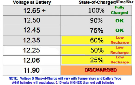

To get a good indication of a battery's status, charge it fully with a known good charger (so called Smart or Intelligent types are best).
The charger should deliver no less than 10% of the battery Ah capacity (so a 100 Ah battery needs a 10 A charger). Then connect the charger for 10 hours, disconnect and leave it for at least 1 hour, then measure voltage. At fully charged a 12 v nominal battery should be 12.65 v or more.

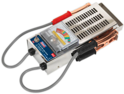

A load test will show the stamina of a battery. A simple load tester isn't very expensive but you could bring the battery to a workshop also.

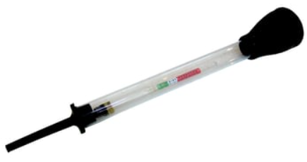

When you have access to the individual cells you can refill until the plates are covered. If curious and research-minded, you can test the gravity of each to tell if any is weak before adding fluid.
Interesting but not very valuable as if the battery is weak, you're going to replace it regardless of which cell(s) are bad.
