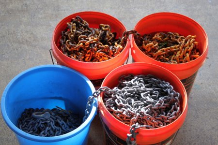

One of the owners of this business down sized the chain to 8mm for his yacht:
- so the idea has endorsement from a reputable builder
Norman R. Wright & Sons – Custom Boats Since 1909
The top 2 drums contain 50m of 8mm chain, the bottom 2 drums contain 75m of 6mm chain. The 6mm chain has the same strength as new 8mm chain, both were tested for tensile strength.

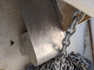

An old trick was to use a traffic cone stood in the locker .... or similar so that chain drops and is deflected by the cone ...
If the chain locker is an open hatch on deck job - I don't really see the problem. Most chain lockers with problem are where chain drops through naval pipe into a bilge space in the bow ...
My 25 - suffers that build up of chain below the pipe .. pipe is plastic that is fitted to base of naval pipe and exits down on the locker ... quite often I can make the boat rock side to side and hear the chain fall ... I have considered a plywood slope to force chain aft into the larger space.

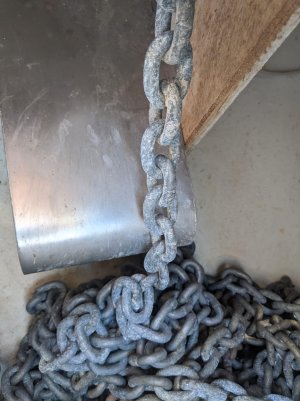

Looks like a great idea. I was thinking of just putting in a 'ski slope' from just under the chain drop under the windlass forward to the centre of the locker.
It's something that I have done for my chain etc, as the windlass is over a shallow section of the locker. Made mine out of ply and used a bit of 40mm waste pipe for the 'end' of the slope which makes the chain come up more smoothly.

We put a slope of stainless steel in the club committee boat & all that happened was that the chain collected at the bottom of the slope & just formed a pyramid that still blocked the chain recovery.
Yes, that's always going to be a problem unless you can drop the chain onto something like a lateral wedge to make it flake.
