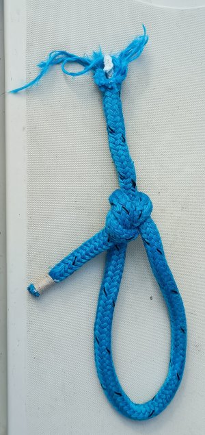

Crikey, it worse than thought. I found this in the cockpit this morning. My boat must have got loose and someone re-tied it for me. It's my stern line, it was looped around a cleat and chafed through at the fairlead.
I will double up my lines when leaving the boat in the future.
I would work out away to stop the wear. Has the fairlead got a sharp edge that's causing the problem ?
Makes sense but I’d also suggest getting some transparent hose of the right diameter in areas where you think their might be chafe. They are a pain to take on and off every time but perfect for those tie-ups before you leave the boat for a period. They will chafe instead of the boat as long as you are careful to ensure the end points of the hose aren’t chafe points themselves. I don’t use any at the moment but when I was at a marina subject to swell they were very useful where two stern ropes had to cross each other to prevent the stern moving wildly from side to side.
A Victor Meldrew moment...
You never used that for a warp!
