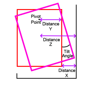

My current boat (camper nicholson 30) is getting a new cooker soon, but I am not sure if maybe an upgrade to a stove with oven is a better choice? Oven makes cooking very lazy and very easy and yet still very good, but I could easily live without it.
So I had a look at some oven units, width wise they'd fit, but I am not sure how much room they need to swing around.
The dimensions are:
  • Width without gimbals: 450mm
  • Width with gimbals: 485mm
  • Gimballing arc: 510mm
  • Cooker Depth (front to back): 410mm
  • Minimum space required when heeled at 30deg: H520xD410mm
So from where do I measure the depth? The 41 cm? From the gimbal fixture or the front of the appliance? Bit confusing because it's identical to the cooker depth
Haven't seen many Nicholson 30s, and the few I have found online just have a little 2 burner hob. It's perfectly adequate, so I wouldn't be too unhappy if it won't fit, but not sure how to measure it exactly.

Make a cardboard template for the side of the cooker. Put a pin in it where the pivot point is. You can now swing it and see exactly what space it needs?
I remove a broken fixed cooker and added a gimballed double burner hob and grill in the rather confined space. I made and moved a temporary pivot point until it would just swing 15 degrees without the back hitting the far wall, or its lower near corner hitting the locker under the cooker. This needed about 4cm of clearance which meant it only just intruded above sink level. Obviously a cooker with oven would need much more particularly toward the rear, however dont use oven at home and dont miss one on boat.
I was thinking of that, but at the moment, there is a cupboard under the hob. So when and if I install the oven unit, I'd have to take that out.
