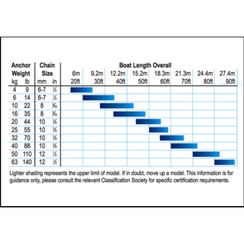

I have 37 meters of 10mm chain at 2.2kg/meter and a 16kg Delta anchor. What is the minimum power in watts of windlass I need, as I seem to recall the rule of thumb is somehow 5 x the combined dead weight in kg so 97 x 5= 500w ? The reason I ask, I just bought a Simpson Lawrence Sprint 1000 which i mistakenly assumed was 1000W but it has a maximum load of 1000lb and a wattage of 400W
