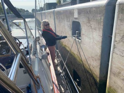

In Belgium the locks are manned, for the moment! in Holland the locks are remotely operated it does make a difference.
On the manned locks here the lock keeper lowers a hook and you put your loop(s) over the hook and he hauls it up to put over the bollard, it is "mandatory" to use two lines ashore in the locks in Belgium but smaller boats can get away with only using the one line - it depends on the keeper.
In the Netherlands we found that using the larger ship's bollards in the locks were easier than using the smaller pleasure craft bollards IMG_0607sm.jpg
Mrs Catt on a rising lock, note that we are well away from the water inrush :)
