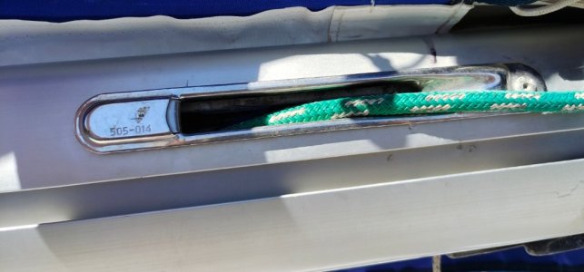

Perhaps this needed more explanation. Two of these in the boom allows reefing pennants to pass inside the boom, emerging at the gooseneck to standard turning blocks and from there upwards to the clew pringles or turning blocks

Ah, yes, I get it now. I was trying to figure out how they would work on the gooseneck casting! A bit rich for my budget, but there's a pile of scrap masts in a corner of the club yard, so I may be able to liberate a couple from there.
One, quite possibly silly, idea I had was that the boom looks symmetrical, so maybe I could invert it, so the sheaves would face up. It's a winter project, so I'm just gathering ideas now.

If you look around the boatyard you will find booms that have slots machined out without fairleads. Doing it by hand I didn't think I could get them smart enough but you may.
When I bought mine, nearly 30 years ago, they were considerably cheaper. I don't think I would pay the ridiculous amounts asked today.

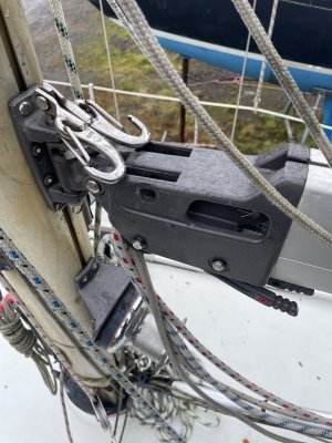

We are exactly in the same boat. Pardon the pun!!. I have a similar boom. Three reefing lines and an outhaul. I wondered if I could add sheives to the top and have two reefing lines going up to the reefing cringles ?

Your boom and gooseneck look later than mine but I did exactly what you say. I replaced the hooks with blocks that are shackled to the clew shackle.

I understand myself now. However the lines leave the boom. Blocks can be fitted at the gooseneck and line head up to the clews and return.

Looking at the photo, you've got a hole that goes through the top of the casting. Could you fit the pin for the sheaves through this so they lead the lines upwards through the slots in the top? You'd only get the two reefing lines, but how often do you need to adjust the clew outhaul?

Yes I could do that. I think there is only room in a/the boom for 2 lines anyway. do you not have the same boom end fitting?. was going to use 2 line but just having 2 extra lines creates problems.
