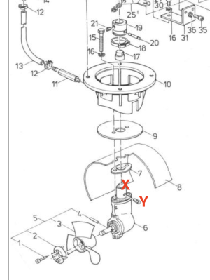

i got an exploded view of my assembly. part X is freely turning, that concerns me as to get access to Y, i would need to haul it.
All I can say is that on mine free spinning was a good thing - meant that the shaft and gear drive to the prop were not fouled in any way - I would worry if it didn't move, then the new pin would snap too. I would just replace and try it - I think they came in a pack of 2 - mine were about £7 for a pair
I suspect that the shear pin (item 4) on the diagram has sheared.
