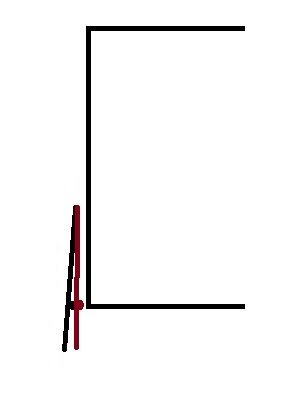

My AQ270 outdrive leg has the limit pin 0ne hole out from most fwd ... the leg appears to be a slight bit prop angled back from vertical.
Angle there exxagerated ... its actually barely visible ...
The boat bow rises very easily as throttle increased and can chine ride at slightest provocation ... the trim tabs do work - but its a delicate op using them. They have no position indication.
I'm wondering if I move the leg to the red line veritcal would this help ?? or make it worse ?

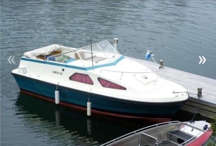

The boat was designed for the 13hp B20 VP .... and the sales photos show her planing well ... (she is a one-off boat though).
Previous owner swapped out the lighter B20 for the heavy B30 engine and leg ... I don't think was a good idea. It makes the boat sit down and aft ...
Here she is before engine change :
You can see she's reasonable level ....

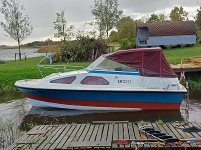

Here she is now with the B30 and visibly not level ! ...

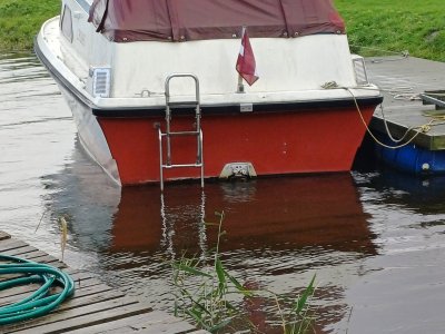

And a stern shot showing the outdrive near full submerged ! ...
Its why I think filling the water tank in the bow might help ....
Nice boat !
When you plane out alone and the engine reaches ~ rated revs but struggle to get on plane with passengers there is no rocket science - the engine simply lacks power for the given boat .
Of course the b30 makes the boat more ass heavy but on the other hand should be significantly more powerful comparing to the b20 .
