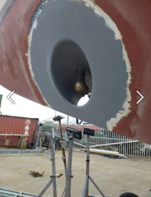

135F9BFA-3E1F-46D7-8EF9-9ADC7321763A.jpegDoes a bow thruster reduce hull strength?
If the hull hit something significant at the lower thin section, is this any weaker - or even stronger - than without thruster installation?

If you think about it, the hull now has a large cross beam strengthening the part of the hull most likely to experience a collision
Momac
7 Feb 2008
7,055
UK
From a high level structural perspective first thought is it looks like the tunnel leaves an uncomfortably small amount of GRP remaining .
Photographs looking from the inside may however add confidence .
