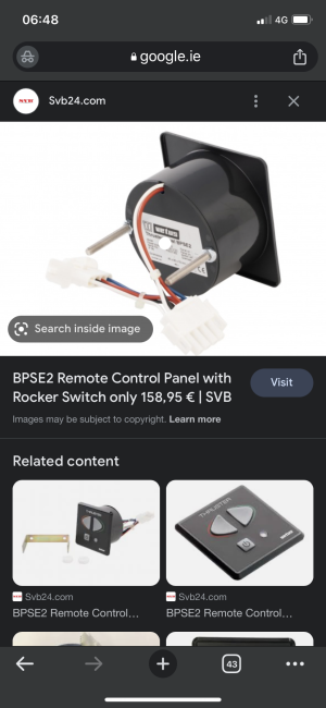

Wow thanks, I understand it better now. So I have a working touch control and module, but I want to connect a thruster control on the flydeck. I bought a Vetus BpSE2 control unit with only 4 wires as in pic. Im guessing that red and black are power and gnd inputs, but there are only2 other wires, not enough for common, left and right direction.

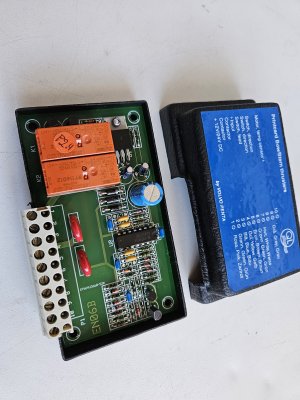

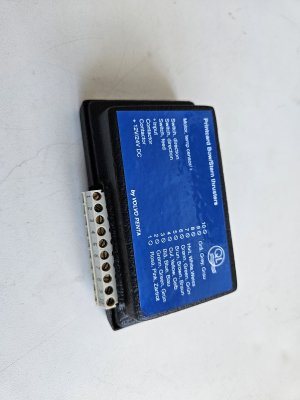

It's very hard to reverse engineer a PCB without a photo but I'd guess there is a timer circuit in there so that if you are running the motor one way then quickly flip the joystick the other way it introduces a second or two of delay.
If this is your own boat, and you're careful, and want to save money, you could dispense with the time delay functionality and just switch the motor with a pair of relays. Usual disclaimers apply!
If you can see a shunt anywhere then parts of the board might also measure current and do something (I dunno what) with that data. Again, if you're careful and happy to take the risk, you could just jettison all that functionality
Presumably it may have an RC circuit to slow the initial spin up to reduce the inrush current.
This will not work with your bow thruster. These controls use CAN bus
You can use some of the Side Power/Sleipner controls, this type should work:
Touch Panel Single - Kuranda UK Ltd
