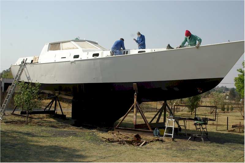

This is the cradle I used when fitting my boat above
Note the bracing and how high it goes up to the supports.
