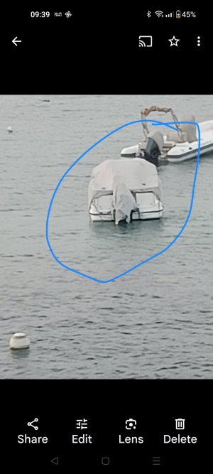

Hi All
Just inquiring in order to search for ideas as i would like to change my boat cover while boat is moored. I have a cover at the moment that cover my center console boat 20 Ft from bow to stern ( even bit on sides )
covers boat really well. However as I use boat on a regular basis and cover is heavy it is getting into my nerves. I dont use studs at the moment just tie downs/ bungees etc . In order to make it a bit easier to cover boat what are your views :
Stainless studs or Not? Studs are easier but have to drill.
Sunbrella material? Boat in Mediterranean sea lots of sun with very high temperatures.
I need something lighter and more user friendly.
I also understand that I can just cover my console only and it will be a breeze but as boat bought new by me im trying my best for ideas to protect boat from elements in a more viable way.
Appreciate your views.
Picture current cover

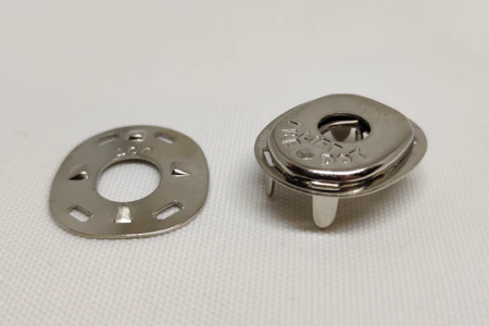

I hate drilling unnecessary holes in boats so would experiment with the tie downs you already have. If you must drill, I have found lift a dot fasteners work well:
The drawback is that the male studs are hell if you tread on them with bare feet, so take care where you place them.

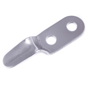

Lacing hooks can work well with bungy cord:
Drawback with them is they can catch lines a be a bit snaggy.
Like @doug748 I think these are the work of the devil! On my next upgrade am moving to these
Perfix Fasteners
Not quite as pointy and kinder under foot or if a skull should contact them at speed.
