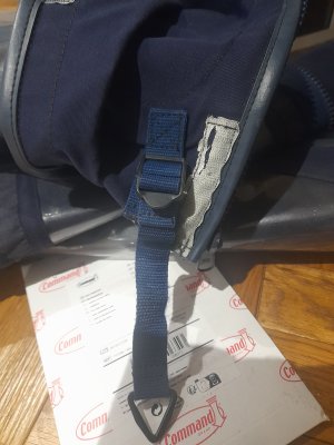

Thanks for that it's the straps with the triangle on.
Oh, I see. You want the webbing straps with the fittings already attached?
I'd be surprised if you could buy them off the shelf. The cover maker made them up to suit.
A simple DIY job if you don't want to pay a cover maker to make them.
If you have a sewing machine, it'd take longer to set it up than to sew a couple of those triangles onto the straps. A 1 1/2 inch overlap, sew all round the edge and a couple of diagonals, job done. Use a UV-resistant thread like this and it'll be more than strong enough.
Thanks I still need the triangular bits
