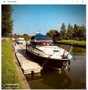

But I do know the boat pictured below which is a Birchwood TS37 has, relatively recently, travelled from the UK through the French waterways to the Med and is now in Malta

Re the blue TS 37 above there are some really great YouTube video's the owner has done on his trip through the French Canals - search YouTube "Stephen J Payne". I started looking at Birchwood 33's (and started a thread regarding re-engining a B33 with smaller engines on this forum in the Spring), there were several for sale on-line. On the Birchwood FB group one owner of a 33 had modified the wheelhouse to drop and get under Osney Bridge at Oxford, with it's 7' 6" clearance. There was one B33 in it appeared very good condition, for sale at 44k, but even then I couldn't get a response from the brokers. One was on Ebay and it appeared couldn't be sold for 16k, very tatty but had been to Paris and was kitted out for continental cruising. Several of the B33's for sale had Ford Dorset 6 cyl diesels, which many told me spares would never be a problem. Ultimately I upped my requirements, looked at two TS37's (both were top quality, but too high to climb up on) but bought an Aquastar 38. I'm sure a B33 wouldn't have too many problems on the main French canals re bridge heights.

Stephen Paynes YouTube channel is Jaywalking the World. Very good watch.

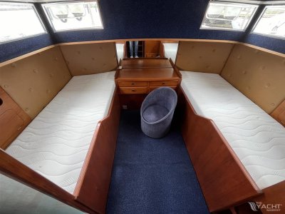

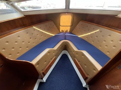

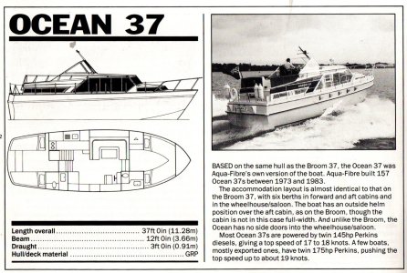

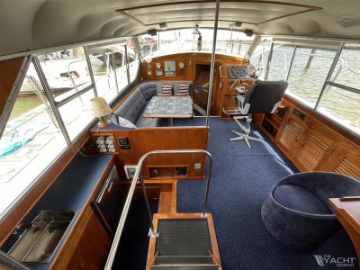

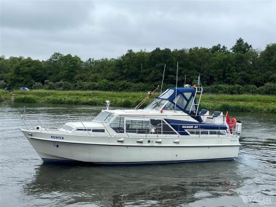

Have a look at some Broom Continentals, Ocean 37’s and Crowns to compare the living space. They are great boats for semi-liveaboard.
Having the Ocean 37 and spent a few weeks on board living and working on her, not that she needed much done, it is a very comfortable boat to be on, our only complaint is the lack of a double bed in the aft cabin.
From @oldgit 's book "25 Years of Motor Cruisers" and how that translates into reality
