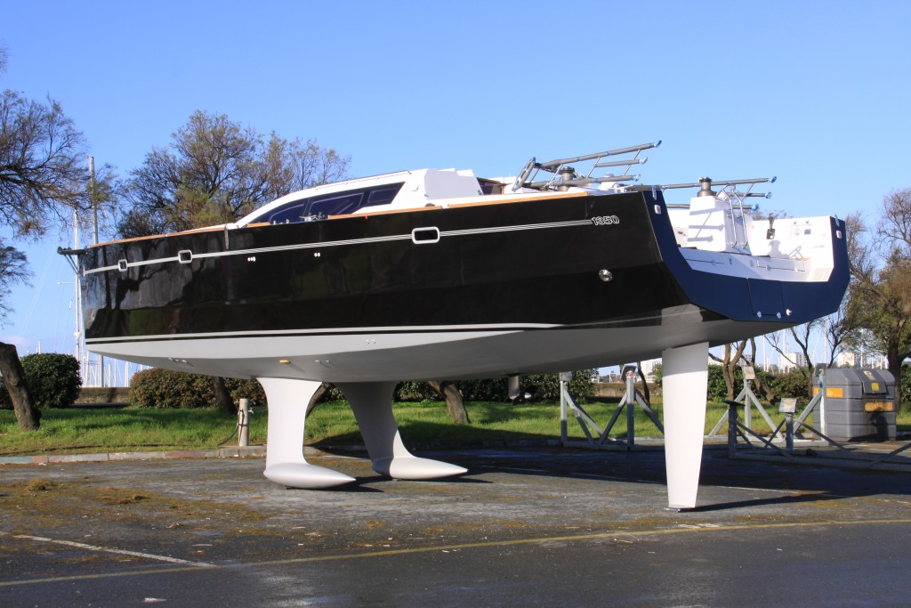

Strange...the styling of the big RM typifies much that I like least about modern yachts...but bizarrely, her twin keels give her substantial appeal to my eyes. I could live with that!

You might find the earlier models a bit more to your liking. Same keels but less extreme hull shape. The old 1050 is particularly attractive. Last one built is for sale on the RM site for a mere 145000 euros!
