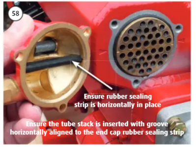

The tubestack must be fitted so that the marks line up but rotate it 180° and they will be correctly lined up again You cannot be 180° out as that will be correct again. There is no distinction between top and bottom

I was at the front of the engine when the heat exchanger was re-inserted and I heard the chap saying to a 3rd person those marks are all aligned now do you concur and he said "Just a smidge more clockwise bud, yeah that's spot on now" it was a couple of mm and then they said it was all aligned perfectly.
It was the next day when he asked me to look at the diagram in the manual and said I reckon Ive got it 180 degrees out. And then said I dont think it makes any difference as long as the arrows on the engine and heat exchanger are all aligned

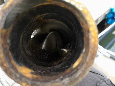

Its only self priming if their are no restrictions on its route back to sea . Ask me how I know. Mine refused to pump after a very roller downwind sail . Checked filter , found empty. So , Sea cock off , pour water in , filter lid back on , cock back open ,engine on and pumping again.
Checked everything from through hull to transom exhaust fitting.
Turned out to be second section of exhaust hose ( water lock outlet ) had been delamination and restricting the flow.
Photo of hose looking in a poor condition

The route for water flow through the exchanger nest is best checked
the Volvo 2000 series engine uses seal bar or diverters which requires the whole thing To be correctly aligned
