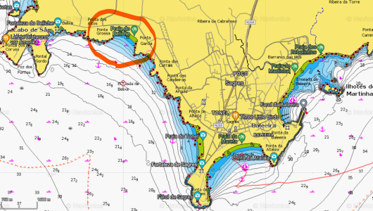

Been past lots of times but not anchored. Looks like it'll be ok to sit out the easterlies tomorrow maybe. Sandy bottom about 3 m minimum, out of the wind, what not to like? Not much ashore though. Maybe one bar. Could take a look at Praia do Tonel on the way round,and see if thats ok. It would be nearer to town but not much. Holiday time so beach may be "busy". Where are you getting the pics from?
1st image from sasplanet, 2nd from google maps 3d. Both extremely useful online resources for cruising. Paia Do Belixe anchorage worked out really well, nicely tucked in out of the wind and waves, was actually more peaceful than when the wind dropped and the swell came back. Don't think of taking dinghy ashore, I shot up the beach on the kayak going in & got drenched paddling like a madman through a couple of waves coming back. Mostly to get some mobile data for a new grib. Nice walk though.
