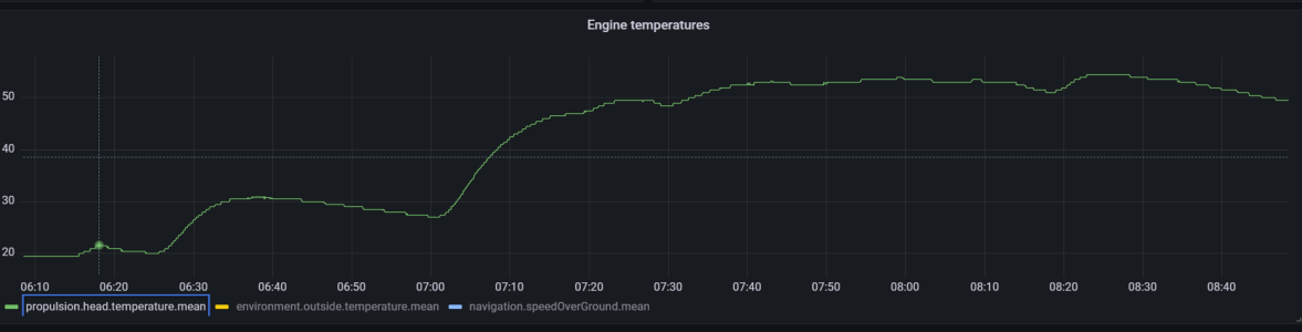

Temperature looks OK, this is thermometer in a lifting lug, usually just over 50deg so looks about right.
