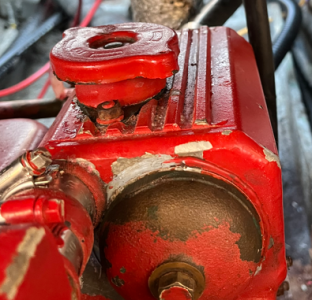

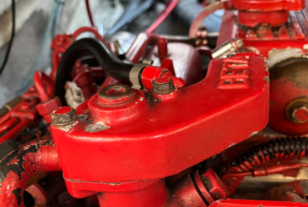

So after switching off I noticed the area around the thermostat was very hot
but around the cooler was cool

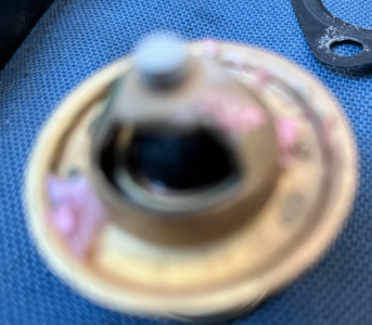

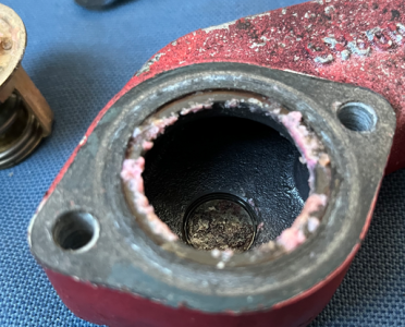

So I open her up and found some pink sludge in there
So I cleaned this up and topped up the water/antifreeze mix. Then I fired up the engine and after 30 mins no alarm.

The anticorrosives in antifreeze are changing from inorganic silicates to organic acids, which have a longer life, in keeping with the long-life engine oils. Your engine may have been filled with silicate antifreeze (usually blue) in the past. If the antifreeze was changed to the modern OAT (often pink) antifreeze without the system being flushed free of the silicate antifreeze, this may have resulted in the formation of gel-like precipitates in the fresh water side of the cooling system. Personally, I would flush the system thoroughly and then use whatever antifreeze you choose, either pre-mixed as shown or made up from concentrate (40%) and distilled water.

I would drain and flush the engine using a descaling agent followed by several freshwater flushes. Then replace the antifreeze with your choice.
The precipitation you have found will be everywhere in the waterways and will move around eventually blocking the smaller passages.
Mixing different based antifreeze is the cause and is to be avoided.
