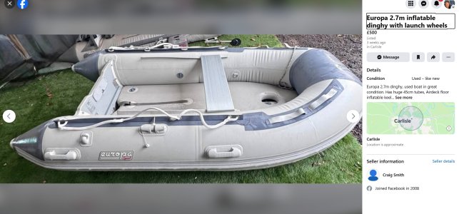

I did spot this, the tubes look the right size but its not a brand I've heard of. There is 2 of these in the dinghy park so maybe its the best option so far.
