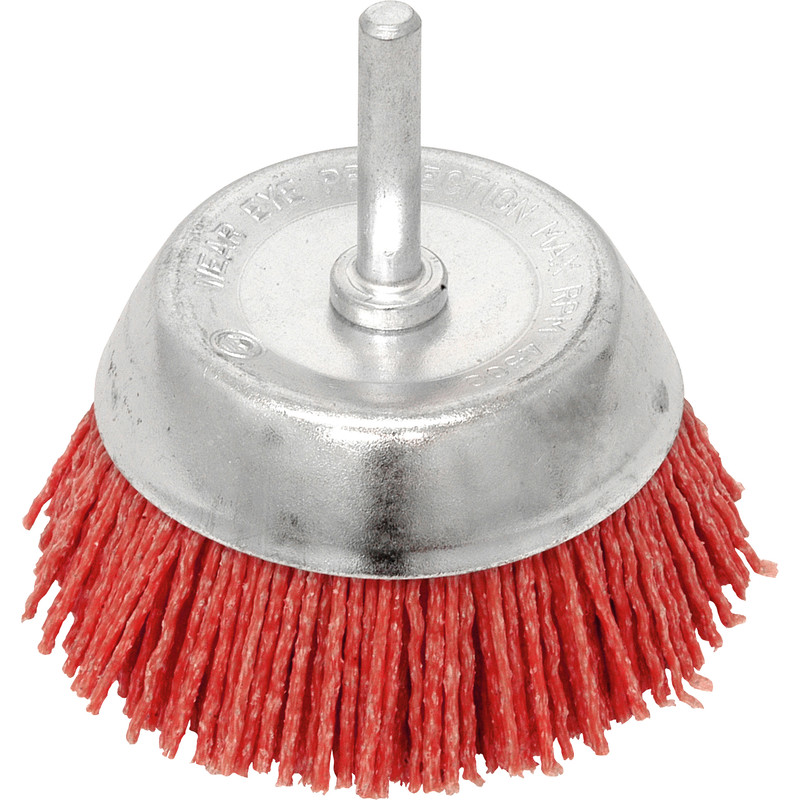

My weapon of choice for sanding less than perfectly smooth surfaces is one of these:
Abracs Nylon Brush End 75mm | Toolstation
or this:
Abracs Nylon Filament Wheel Brush 75mm | Toolstation
