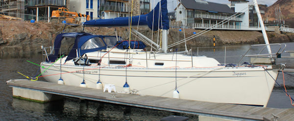

Duncan Wells in "stressfree sailing" recommends a bridle running from eg midship cleat forward to a snatch block or similar

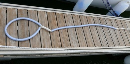

In which case we lasso the bow then motor slowly astern until the other ropes are on. It helps if we are in a stbd side berth as the stern kick pins us to starboard. Personally I would ask for a better berthWe do that too - with the end led back to genoa winch so can quickly spin in the slack and set a precise length.
But the OP said their pontoon was too short for this to work.
