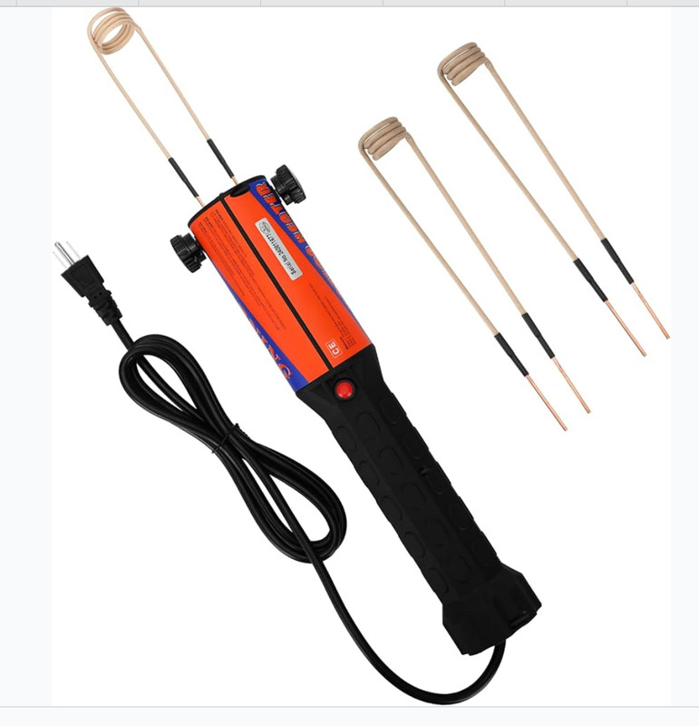

But if the kink is by the base you will have to remove the stanchion otherwise you will get the base hot as well. My bases have plastic inserts. Once hot you still have to bend the stanchion straight & that will take lots of pressure. Hot or not. So damage to the base is still a possibility
Good idea. I have both steel offcuts, a lathe & a slightly bent stanchionMy plan was to turn a piece of steel round to fit. Or - since I longer have my lathe - get it turned.
Induction heaters don't work on 316. They are for mild steel.
Really ?…I didn’t know…I will do the experiment and get back to youInduction heaters don't work on 316. They are for mild steel.
Ah, it's not magnetic.Really ?…I didn’t know…I will do the experiment and get back to you
Although there is a lot online about using induction heating in ss…it probably can’t do 316…I tried a A4 bolt and it wouldn’t heat up enough.Ah, it's not magnetic.
No need to delete, we have all learned a bit from this.Although there is a lot online about using induction heating in ss…it probably can’t do 316…I tried a A4 bolt and it wouldn’t heat up enough.
Up until this thread, I did not know this…live and learn. I will see if I can delete my original post
Why? Have you got a log burner?No need to delete, we have all learned a bit from this.

I use it to bend metal.......it instantly heats metal until it’s malleable ....it puts the heat safely exactly where you need it. The elements can be bent to fit any job...including the head of a bolt that is stuckInterested in induction heating. My old lathe bed was induction hardened I seem to remember. What would you use that tool for? Heating and then carbonizing?
More evidence for the argument 'get a new one'.I use it to bend metal.......it instantly heats metal until it’s malleable ....it puts the heat safely exactly where you need it. The elements can be bent to fit any job...including the head of a bolt that is stuck
Thanks. Don't think I have a use for it if it doesn't work on ss. I did weld a couple of nuts onto broken engine mount studs a couple of weeks ago (I had to grind off the tops). That worked well to extract them. Cheaper than buying an induction heater if you already have a small welder.I use it to bend metal.......it instantly heats metal until it’s malleable ....it puts the heat safely exactly where you need it. The elements can be bent to fit any job...including the head of a bolt that is stuck
