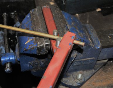

I have one of these:

but not used it yet. It may offer leverage and the necessary tube support if I think about it.
Vevor tube bender in case the link doesn't work for you.
My plan was to turn a piece of steel round to fit. Or - since I longer have my lathe - get it turned.Trouble with those benders (i have a more industrial version) they do not bend a bit right at the end. One needs a few inches on the bender to stop the wheel jumping off. The bend in the stanchion will be within an inch of the end where it enters the socket. Those benders will probably not straigten that bit. You might get away with putting a tight fitting tube as an insert inside to extend the tail but first you have to find the insert.
