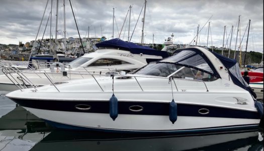

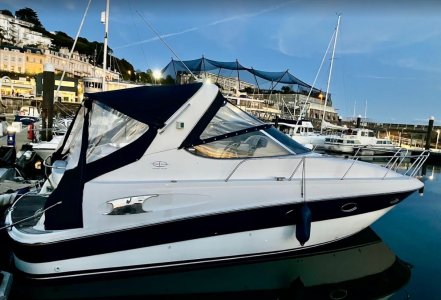

I've just purchased a Bavaria BMB 300 Sport cruiser. It was a last min change of plan from a Fairline Targa 29 as we preferred the interior layout.
I'm very pleased with it but there are a few "projects" I'd like to undertake.
Diesel Heating, Anchor Windlass, change stove from alcohol to gas, replace the windscreen seals and upgrade the canvas covers.
The model is really not very common, so hard to find pictures and guides for what others have done. Unlike the Targa 29.
By any chance are there any other owners on here who may wish to discuss their upgrades with me ?

If it was a guess where photos taken
.1 Torquay and 1 Brixham

Thanks guys.
The boat is in Torquay now. Purchased it in Brixham. So good photo spotting.
