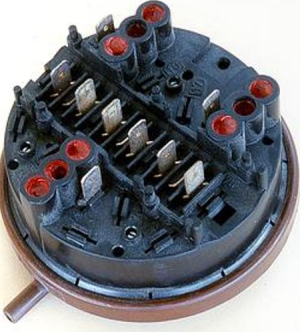

Does anyone have experience of pneumatic switches?
It seems like a good idea as it keeps the switch out of the water. Years ago someone sold a washing machine water level switch as a bilge pump switch. I kept the switch when I scrapped my previous washing machine but haven't yet got around to trying it out. They have contacts for several different levels and are adjustable.
I bought a basic washing machine water level switch on ebay and installed it 11 years ago as a warning device and it still, works perfectly. If you add a relay it will control a pump too. As the electrical part of the switch, and the relay, are mounted way above waterlevel they will be very reliable
