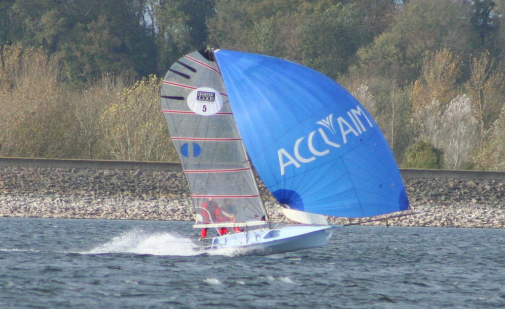

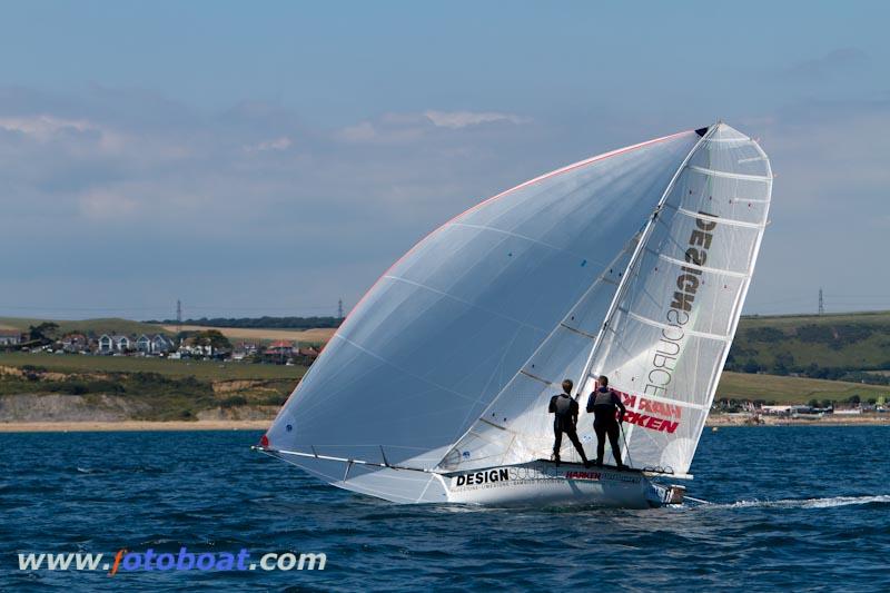

The issue with lee helm on a big assy boat, when trapezing, is that you get pushed off the side of the boat. I used to race 12' skiffs, which in the size of assy to size of boat ratio, win hands down. On these boats, you need to throw away the mantra of "flat is fast" which is drummed into every dinghy racer from day one, and actually let the boat heel until you get an acceptable level of lee/weather helm balance. Obviously you are doing this by going up/down on your heading...don't be sheeting in/out, just steer the boat.
Wow...this first shot was 12 years ago now!
The boats have 4 rigs, this below shot is the big rig and heel is even more pronounced...
