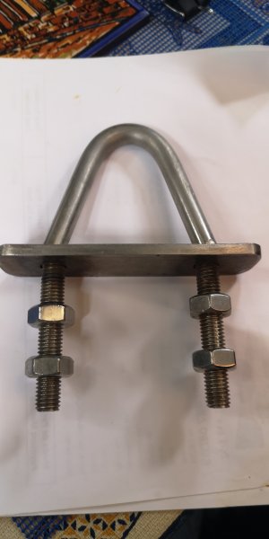

I had new ones made at the time, but rejected them because the threads were welded onto the plate separately (I noticed because the threads underneath the plate were slightly offset from the arms of the loop above the plate. A friend who was an enginerr opined that he would not yrust these, so I replaced the originals). I still have them on board somewhere.

Have had a closer look and only the two aft chainplates are suffering appreciable/noticeable corrosion to the mild steel. I did, as I say, get two new U-bolt deck fittings made up 6 years ago, but didn't like the look of them (see pic) so put the old ones back.

Why did you not like the look of the U bolts as shown.
The only issue I can see is the 2 of the nuts need to on top of the plate and the U bolt needs to be bend over to be inline with the rigging to have a better pull line
