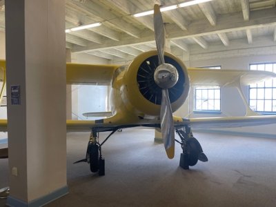

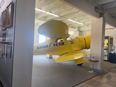

I have one, courtesy of our recent visit to Kansas. Touched the prototype of his design, in the museum in Wichita, site of the Beechcraft works. There was his photo on the wall of fame. I have his book, my father gave it to me aged 14. Much of it is still relevant. And here’s his creationIMG_6767.jpegIMG_6766.jpeg

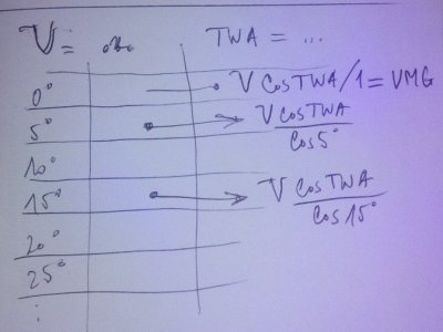

For a more general one, in particular if you have live feed for boat speed and TWA, you might try this
Input boat speed V and True Wind Angle TWA.
Cells are for 0 - 5 - 10 - 15... degrees deviations from dead downwind, say each angle measures Dev°
In each cell you compute the value V x (cos TWA)/(cos Dev°)
The value at 0° will give your current VMG.
If you are going at 5kt, 10° to the wind, you will find your speed value 5kt in the 10° cell, all other cells will tell you the breakeven speeds at those angles to the wind; the 0° cell will give your VMG.
Depending on TWA being 0 - 5 - 10 etc or 180 - 175 - 170 you might need to change the cosinus sign.
If the destination is not straight downwind then more trigs are needed to transform VMG into VMC :)

Cheers. Might even have a play tomorrow if there's enough wind to sail. Suspect this anchorage will start to get a bit rolly soon so seems sensible to move on. lovely though it is.
