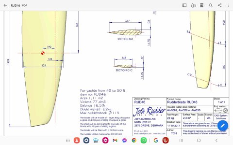

The full engineering diagram of the Arcona 460 rudder stick is shown in the link in post #20.
The stock covers the majority of the blade - but suspect like other Jefa rudders (and other Scandinavian boats) the bottom few centimetres of the rudder tip are indeed designed to be sacrificial if have a grounding on a rock or similar.
Jefa rudders in general will have been well tested with rock groundings, being so common on Scandinavian and Baltic built boats- as well as hundreds if not thousands having done trans Ocean voyages.
I had a look at the jeffa site. I don't know which cruising rudder the Arcona would have but choosing one for a 42 to 50ft boat, the rudder weighs 22kg and has a volume of 77 litres. The aluminium shaft can't extend close to the bottom of the rudder due to their shape unless they machine a lot of the stock away. Either way, it's possible that the rudder is bouyant.received_731198645878815.jpeg
