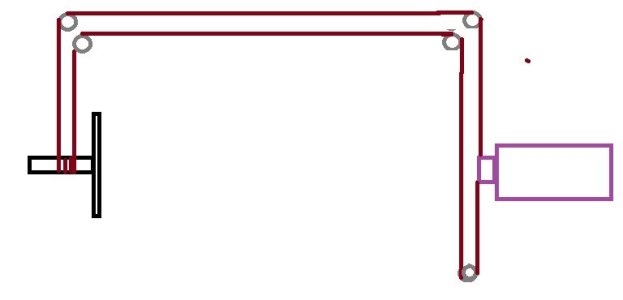

Could an 'endless loop' cable do the job ?

My Soviet speedboat has a 4mm braided line wound 4x round the steering wheel shaft .... then the two ends via pulleys to transom ... where one goes to other side of boat round a pulley and return to the outboard .... other one round pulley and to outboard bracket .... basically wheel shaft rotates as you turn wheel .... pulls line to steer the boat. Simple and works surprisingly well .. with very little slop as the lines have small bottle screws to tension and adjust to centre. Its a Mariner 20hp - so a reasonable amount of force needed ..
