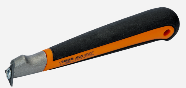

Unless the surface to which the remnants are attached is smooth,you wont have much luck with a power scraper, since it won't get into the hollows.

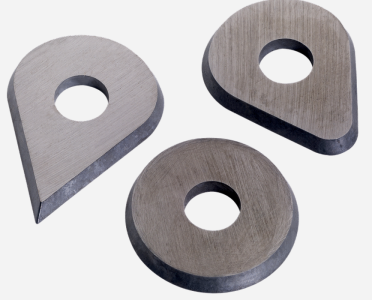

When I had to do this job I used a wire brush and a Bahco 625 scraper with a pear shaped blade.
And there's a version with a ball at the sharp end that's much easier to put pressure on...
