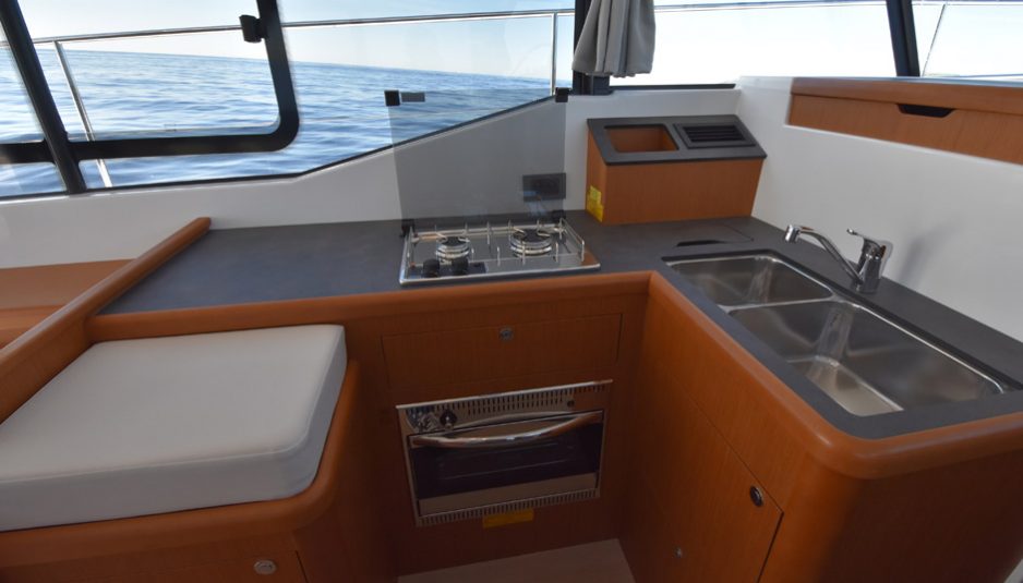

I know it sounds crazy, but the designers of the new Beneteau Swift Trawler 35 put a cushion on the kitchen counter top and called it a forward facing seat
