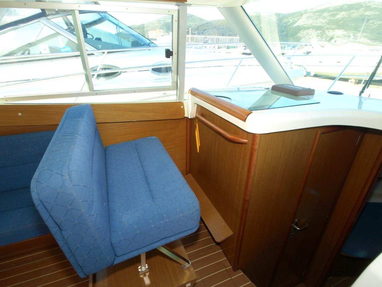

I thought the passenger was supposed to ‘perch’ on the back of the seat to see forward, hence the space and top cushion. A seat there would be too low. The PO of mine created more deck space by doing away with the gap and shortening the seat, hence more room and bigger table but no saloon berths and still no forward seat. Mrs JD either stands, sits on the rear forward facing seat or….nicks my chair and steers ?
Nice layout - looks good!
Mine is also set up along those lines (added a bench where your port seat is, got rid of the bed and the fwd folding section that lifts with the engine hatch) but not quite as well made :giggle:

If you want to copy I'd suggest to either source the seat and/or bracket for Jeanneau Merry Fisher 925 or view one somewhere with a tape measure and a camera :)
I am reluctant to post a negative reply but my experience was that SWMBO soon got fed up with not facing forward. The best compromise solution I saw was to insert a Stool in the gap between navigator seat.. A 760 owner in MDL Chatham showed me his . The size of the stool ie footprint is difficult to find but one could make or modify one. The small space prevents the stool moving.

I am tempted to buy a Beneteau Antares 760 except that it lacks forward-facing seating beside the single helmseat. In my search I found that such seating is commonplace in many similar boats, and a very welcome facility.
I have tried to figure-out a retrofit design, but failed due to the geometry of the existing wheelhouse seating.
Has any 760 owner managed to do this ? Please let me know if you have - photos or sketches would be particularly welcome.
