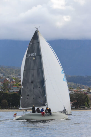

The Queensland Police did not identify the vessel, but Australian sailing community forums and the boat's previous owner named the yacht as the Sayer 11 racing boat Runaway, a carbon fiber high-performance monohull designed for the 2003 Melbourne-Osaka Race. The vessel reportedly sustained keel damage once before, during the 2007 edition of the same event.
One Dead in Yacht Capsizing Near Great Barrier Reef
Speculation it hit a whale on the boats FB page. Log into Facebook

Neeves
20 Nov 2011
12,505
Sydney, Australia.
This link offers a photgraph of the upturned hull but it not of sufficient quality to to see detail of the area of the break.
Yacht loses its Keel
