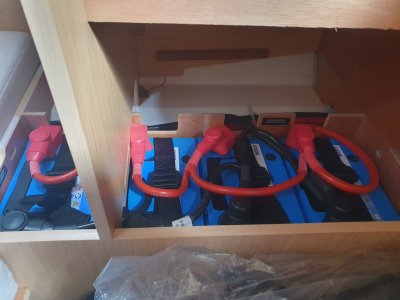

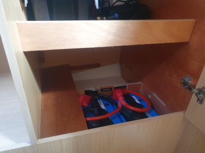

Here is the space I have to work with. Beneteau have built the compartment to exact sizing so very difficult to rework. There is another space behind the engine where a new tray could be constructed, room for a 3kw inverter etc. That option is going to be a lot more expensive than a flooded > AGM swap.
From left, one engine start battery, three domestic batteries. All Exide ER350s.

6 in parallel! Trying to maximise use of existing space, the 290 fits nicely into the space, the 230 might be tight as it's 10mm longer than the 290.
520L x 270W x 225H = Available space (+/- few mm)
521L x 269W x 224H = Rolls 290
530L x 209W x 218H = Rolls 230

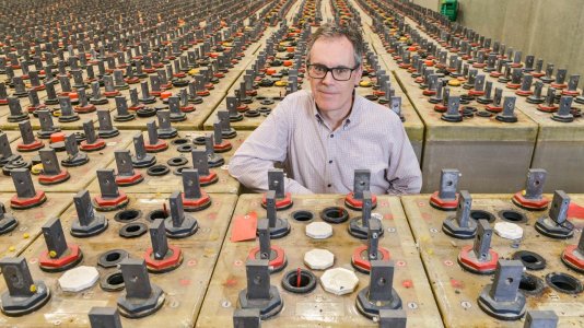

Some time ago I visited the HQ of a major organisation who ran a very, very large mission critical IT system, no names no pack drill, on touring their power facilities I entered their battery backup room was confronted with a battery bank the size of a shipping container.
Where do these guys come up with such silly ideas?

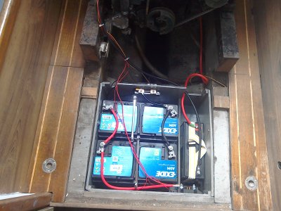

Have you considered using the space behind the engine to fit a high powered AGM start battery such as a Red Flash or an Odyssey then seeing whether you can get more domestic capacity in the existing space, either by 4 of the existing size or 2 larger ones. The photo shows my installation with 2*895ah Exides and an Odyssey. There is a custom mounting box available for the odyssey for when they are mounted on racing cars siting on top of the gearbox which will fit well on a vertical bulkhead
The Odyssey is this one demon-tweeks.com/uk/odyssey-extreme-power-motorsports-ods-agm-battery-7000367/

Some time ago I visited the HQ of a major organisation, no names no pack drill, on entering their battery backup room was confronted with a battery bank the size of a shipping container. Where do these guys come up with such silly ideas?
Quite often charged in series sets of 4.

Exide supply and fit submarine batteries in both parallel and series combination as required. The difference is that they are being monitored 24/7 and, as well as lots of different charging / discharging routines for optimum performance. The fluids can also be agitated to prevent stratification.

I have the same problem in that the house battery is heavy.....although my installation under the companionway stairs looks easier than yours....my solution is to carefully study the move in all aspects....I told the delivery guy where to put it (right next to the boot of my car)....so only one lift into the car. And used a hand trolley to get to the boat...and a dolly on wheels on the pontoon and through the boat....this might seem off point but the logic is simple ....one lift is going to be hard...getting the big battery into a place it doesn’t want to go...so save all your energy for that task only.
Unless that cabinetry comes apart...the battery has to slide in at an unnatural angle....I don’t know if it will go. If you plan on using a plastic battery box that will be the approximate size of the battery....if you can get the battery box in you probably can get the battery in. Good luck👍
