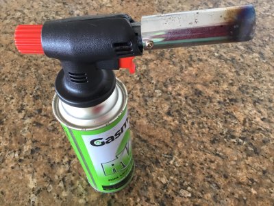

When you say a blow torch, would a gas powered soldering iron work or does it need something a lot stronger?
I just use, as we carried one, an Aldi blow torch that you use to make creme brûlée (as I assumed everyone made creme boulle on their yacht :) ). You used to be able to buy little blow torches, like a rather powerful cigarette lighter - they would do. I'm not sure that a gas soldering iron would work as getting the tip of the iron to transfer enough heat might not work (though your gas soldering iron might be better than mine).
It does not need to be a 'real' blow torch.
You obviously need to be able to hold the shackle when you heat the threaded portion, Mole wrench works.
You can also buy cheap blow torch attachments to the little BBQ/Korean/Japanese stove cylinders, the sort that come in a pack of 3 cylinders. The blow torches are good for short usage (like freeing up a shackle pin) but not so good as to melt lead out of a Spade anchor (which takes a long time and lot of heat).
Jonathan
I bought this in a Chinese supermarket, it was along with their BBQ stuff (I think its sold to help start a charcoal BBQ). But I have seen them in Bunnings - sorry but I don't know the name of a single UK DIY shop. It cost about stg5 and clips onto the pictured gas cylinder. If you look carefully, top centre of the picture you can see the plastic has started to melt - that was when I was using it to melt lead and had used a lot of heat. It works well to free up shackles but has quite a big jet of flame so not so good for focussed detailed work. You just open the valve, knurled knob, and pull the trigger - it lights instantly.
On the other side of the blow torch is a 'name' or label 'HS SKY-501'
I'm not sure that it would meet H&S approval. :)
The Aldi blow torch is much smaller and better for detailed work. Both are good if you need heat at the top of a mast.
I have found both useful, shrink covers on cables and rope, freeing up bolts secured with Loctite, freeing up 'corroded bolts - usual stuff where you need heat - and they are cheap. If you need a lot of heat, melting lead out of a Spade anchor - buy a better blow torch (which I also have for that application). When you are melting lead you want a bit more space between you and the liquid metal which you don't get with this device.
