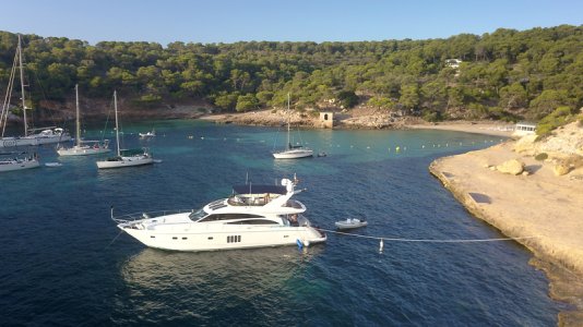

This is a well known anchorage in Mallorca where you aren't supposed to do this but we did it and other sailing boats then joined in.
And this spot in San Miguel (Ibiza) is easier - less other boats around.
Best if you have good ground tackle (anchor etc) so that you can tighten up the line ashore so tight that you can play a tune on it.
We have actually "sat out" 50 knot winds using this technique.
