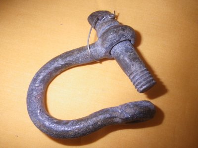

This is a wired, rubbish, shackle. The shackle failed. The pin pulled straight out of the thread (Loctite would have been no use either).
The owner lost a new Anchor Right Excel anchor - check the value of the anchor on Jimmy Green's website - lost because of a non rated shackle.

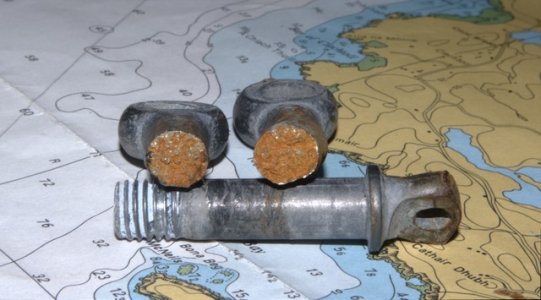

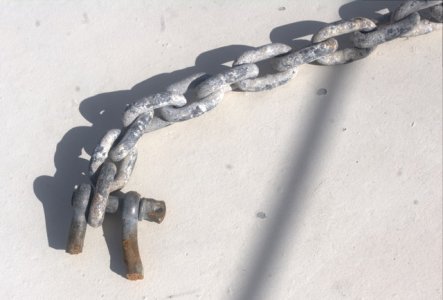

This image was supplied by a member here. Not a rated shackle, failed on retrieval of a Rocna anchor. Apart from not being rated its the wrong shackle anyway. Use a bow (sometimes called an anchor) shackle

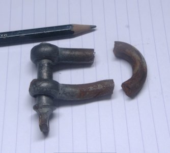

That photo of a failed shackle is literally amazing. It is very difficult to imagine the forces that were applied to it to cause it to fail in two separate places at the same time. Is there something that we're not being told here?
First I would like to see the fracture face to see what the grain structure looks like.
From the pic it looks like a brittle fracture but difficult to see clearly

Yes brittle fracture but the grain size looks big so I would question the heat treatment process and the hardness of the final metal
Comparing the chain size with the shackle size the shackle being bigger this must be a faulty shackle
What grade is the shackle and the chain
To help in an analysis here are 2 more pictures of the same shackle failure

That is very strange. It does have a brittle appearance with no obvious sign of progressive failure as with fatigue. It appears to be a galvanised steel shackle that pretty much rules out SCC.
The only suggestion I have is temperature related. A dead mild steel with no manganese content has a ductile/brittle transition temperature close to 20C. I can see slight plastic deformation that implies load application. Not knowing the circumstances, if a sudden load was applied at a temperature below 10C it could result in a brittle fracture, which would at least explain the twin breaks.
The only other example I have worked on was a windlass drum on a ship in the Arctic. I know of many others, Liberty ships, refinery vessels, etc but most were at 0 - 5C.

I don't have the pieces - only the picture and the sorry tale of the lost Rocna anchor.
Never guess but the I might assume a G30 chain. The shackle is unrated, no Grade - just one of those shackles, maybe, you can buy in your local hardware store (to secure your dog)
The owner said the shackle failed when it hit the bow roller - so I assume (again never guess) that the actual failure occurred prior and the hitting of the bow roller was the final straw that broke the .....Interestingly the shackle shows little distortion.
