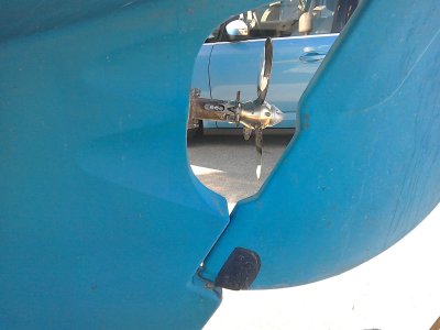

Check that the cutter is positioned correctly in relation to the striker block. The tongue should be 6mm away from the back of the slot. Do you have the anti rattle plates fitted? Check the bearing rings are not worn.
This is what it should all look like.

I have checked the installation and it looks OK to me (thanks for the photo Tranona). How do you assess if the plastic bearings need replacing? They are there and visible but I don't know if they are worn beyond their useful life?
When you move the shaft it does make a very loud clicking between the fixed blade and striker plate something akin to a set of wind up comedy teeth 🤭.
